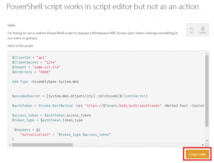

I'm trying to run a custom PowerShell script to request a Workspace ONE Access Sync when I change something in our users or groups.
Here is the script:
$ClientId = "api"
$ClientSecret = "1234"
$Tenant = "some.url.tld"
$Directory = "0000"
Add-Type -AssemblyName System.Web
$encodedSecret = [System.Web.HttpUtility]::UrlEncode($ClientSecret)
$authToken = Invoke-RestMethod -Uri "https://$Tenant/SAAS/auth/oauthtoken" -Method Post -ContentType 'application/x-www-form-urlencoded' -Body "grant_type=client_credentials&client_id=$ClientId&client_secret=$encodedSecret&scope=admin"
$access_token = $authToken.access_token
$token_type = $authToken.token_type
 $headers = @{
    "Authorization" = "$token_type $access_token"
Invoke-RestMethod -Uri "https://$Tenant/SAAS/jersey/manager/api/connectormanagement/directoryconfigurations/$Directory/sync/v2" -Method Post -Headers $headers -ContentType "application/vnd.vmware.horizon.manager.connector.management.directory.sync.trigger.v2+json" -Body '{"ignoreSafeguards":"true"}'

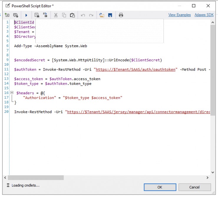

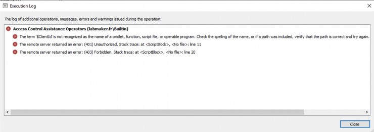

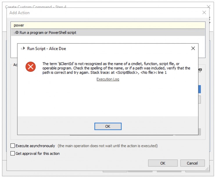

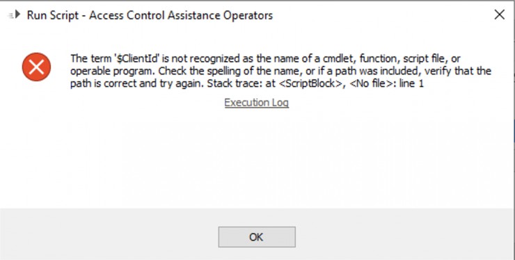

This script works in PowerShell directly, and works when run in the Adaxes full script editor. But when I try to run the related action (manually or with a real event) if fail reading the first line, whatever the firstline is (comment, empty, variable…).
How can I solve this?
Side question: is there a way to create a business rule that catch all directory event (create, update, delete) for Users and Groups (instead of having to create 6 independent rules with each of them a copy of the script)?
As per our check, the script works fine. Most probably, there is some unprintable character in the script which causes the issue. To remedy the issue, try copying the script to notepad and then back to the script editor.

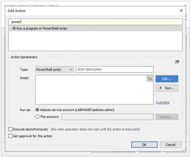

I've tried on a new Custom Command. Same result, but I didn't found a "Copy Code" option. Where is it?
Here is the screen shot of what I did step by step.

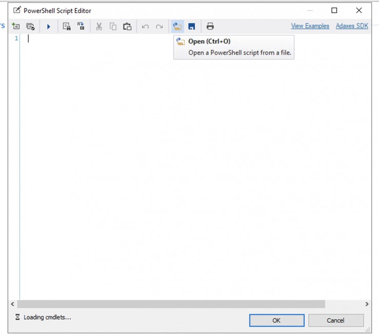

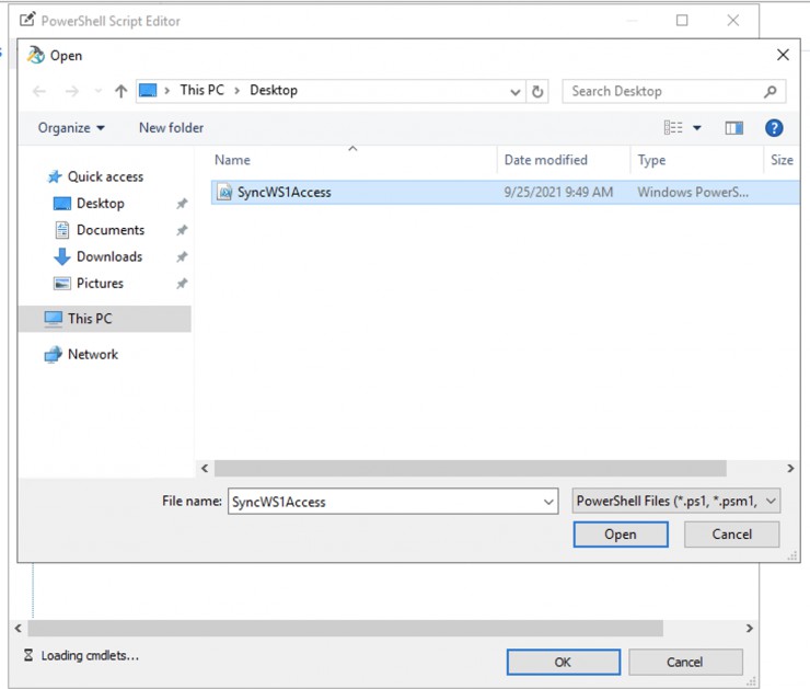

  • Here I pick the PowerShell script I want Capture d’écran 2021-09-29 à 19.42.25.png

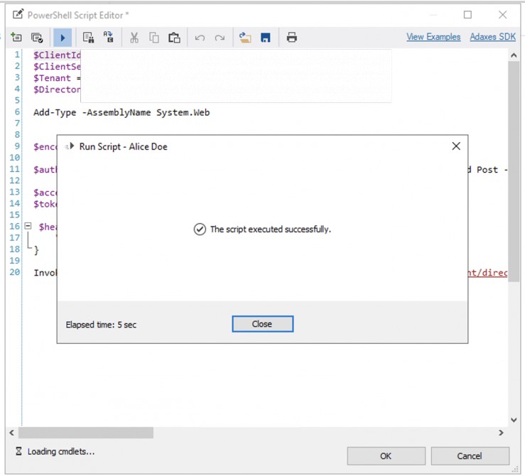

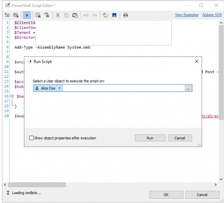

  • It load it correctly, then I clic on Run Capture d’écran 2021-09-29 à 19.42.33.png

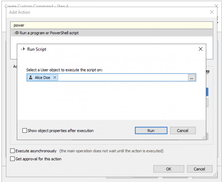

  • I target a sample object to run the command Capture d’écran 2021-09-29 à 19.42.53.png

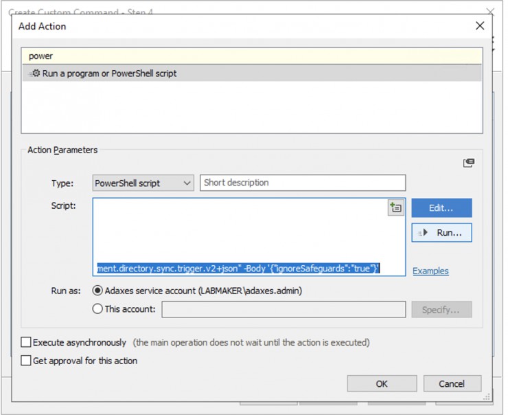

  • I close the editor and come back to the action, click Run again Capture d’écran 2021-09-29 à 19.43.19.png
We meant the Copy code button below the script you posted here. image.png You can also try to rewrite the first line in the script manually after pasting the script into the editor.
So i had to fix the exact same issue today. What i did was copy and paste the script 1 line at a time and run the script with each new line eventually i found the line that was causing the problem and manually retyped it and it solved the issue for me.
