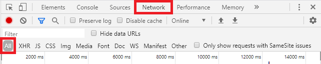

  1. Open Adaxes Web Interface page in the Google Chrome or Mozilla Firefox web browser.
  2. Open DevTools by pressing F12.
  3. Click Network.

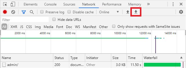

  6. After the page is loaded, export data in HAR format. To do so in Google Chrome, click the Export HAR button. image.png

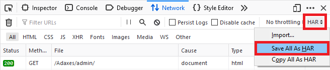

  7. In Mozilla Firefox, click the HAR button and select Save All As HAR. image.png
