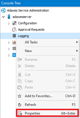

Yes, it is possible. You need to disable logging scheduled tasks execution. It can only be done for all existing scheduled tasks. To disable logging the operation:
  3. Right-click Logging and then click Properties in the context menu. image.png

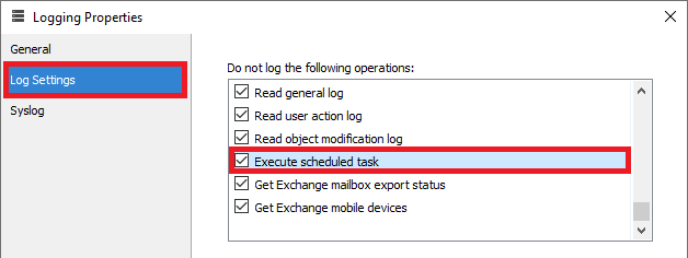

  4. Activate the Log Settings tab.
  5. In the Do not log the following operations section, select the Execute scheduled task checkbox. image.png
  6. Click OK.
