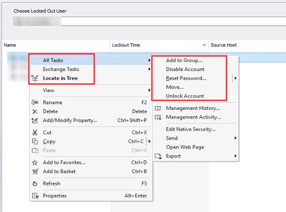

With regards to the report, I managed to get it working and have it return the information I want. I also discovered that when returning a full AD object, as is the case with DirectorySearcher or BindToObjectByDN, it allows the end user to execute relevant right-click options on the user account, vs. just having the ability to export the report when returning a simple custom object.

            $Events = Get-WinEvent -ComputerName $ComputerName -LogName Security -FilterXPath $filter
            $columnLockoutTime = "{6ebb67ec-d4a7-444e-9a64-3e703a87634c}"
            $columnSourceHost = "{29768609-7d15-4cea-a2f5-40a47fc78442}"
            # Add item to report
            $Events | ForEach-Object {
                $columnValues = @{ }
                $columnValues.Add($columnLockoutTime, $_.TimeCreated)
                $columnValues.Add($columnSourceHost, $_.Properties[1].Value)
                $Context.Items.Add($ADObj, $columnValues)
            Throw $_.Exception
$ADSearchDN = $Context.DirectorySearcher.AdsPath.DN
$ADObj = $Context.BindToObjectByDN($ADSearchDN)
$LockedOutUser = $ADObj.Get("SamAccountName")
Get-LockoutBlame -UserName $LockedOutUser
