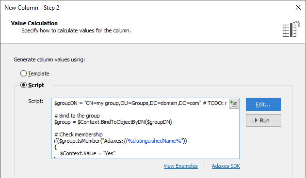

The main thing here is that you are using the Get method for a multivalued property which will not work. To achieve the desired, use the below script for the custom column generation. In the script, the $groupDN variable specifies the distinguished name (DN) of the group to check. For information on how to get an object DN, see http://adaxes.com/sdk/HowDoI.GetDnOfObject.
$groupDN = "CN=my group,OU=Groups,DC=domain,DC=com" # TODO: modify me
# Bind to the group
# Check membership
if($group.IsMember("Adaxes://%distinguishedName%"))
    $Context.Value = "Yes"
    $Context.Value = "No"

As we mentioned in the answer, the script should be used in the report custom column. The script will not work anywhere else. In this case, the %distinguishedName% value reference will resolve into the DN of the object being added to the report. image.png If this is not what you need, please, describe the desired behaviour in all the possible details with live examples.
As for Adaxes://%distinguishedName%, it forms the ADS Path of the object.
