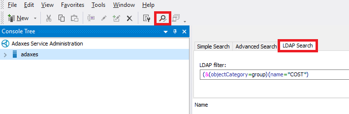

Writing COST without wildcards (they are applied in the script) should work just fine. Are you sure that there are groups managed by Adaxes that have members and have the COST part in the Name property? You can find the groups using the below filter in LDAP search in Adaxes Administration console:
(&(objectCategory=group)(name=*COST*)
I can find it when I search with CN on Ldap search.
(&(objectCategory=group)(cn=CONST))
