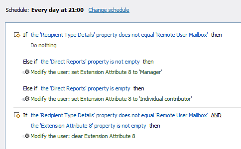

Thank you for clarifying. In this case, you do not need to use scripts. The scheduled task will look like the following:

Thank you, this worked flawlessly for one domain in scope but not another. I did select All Objects and exclude deprovisioned objects. Please advise as to what to check.
Please note: the ones that were successful were on prem Exchnage users syncing to O365 and the ones that failed are online only.
What exactly do you mean by the ones that failed are online only? Are they on-premises AD uses not synchronized to Microsoft 365 with mailboxes in Exchange Online? Are they cloud-only objects?
by (3.2k points)
we have a hybrid environemnt, one doomain has on prem AD and Exchange and sync to Azure/m365. They were successful. One domain has on prem AD and NO exchange and only Exchange Online, these all failed.
Thank you for clarifying. In case when all users have mailboxes in Exchange Online (it is the case for remote mailboxes as well), you need to use a different approach. To achieve the desired, replace the condition for the Recipient Type Details property in the first action set with the following script:
$Context.ConditionIsMet = $Context.TargetObject.MailboxType -eq "ADM_EXCHANGE_MAILBOXTYPE_USER" -and `
    $Context.TargetObject.RecipientLocation -eq "ADM_EXCHANGERECIPIENTLOCATION_OFFICE365"
In the second action set, replace the condition with the following script:
$Context.ConditionIsMet = -not($Context.TargetObject.MailboxType -eq "ADM_EXCHANGE_MAILBOXTYPE_USER" -and `
    $Context.TargetObject.RecipientLocation -eq "ADM_EXCHANGERECIPIENTLOCATION_OFFICE365")
