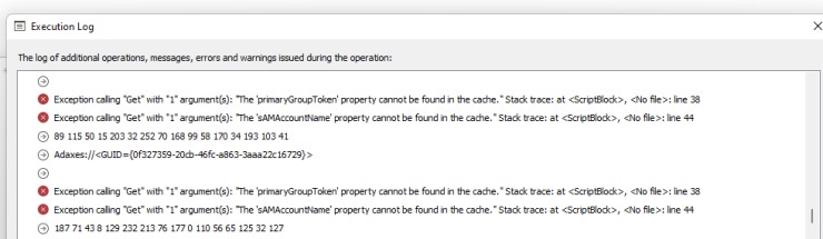

Hi, we've been using this script for some time but after the upgrade to 2023 it's now erroring out as below:
image.png As you can see I've done some logging out of variables, and the issue looks to be that the lineĀ $group = $Context.BindToObject($groupPath) is not returning an object. Any suggestions of how to fix?
Thanks,
Allister
by (50 points)
by (306k points)
Hello Allister,
The issue occurs because you are using Adaxes 2023. The old version of the scripts were not adapted for it. We updated all the three scripts accordingly. Please, clear browser cache, refresh the page and copy the script you need from the article.

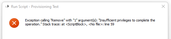

Thanks, I've updated the script and now I'm getting this error: image.png Line 59 is this: $group.Remove($Context.TargetObject.AdsPath)
Cheers, Allister
by (306k points)
Hello Allister,
For troubleshooting purposes, please, connect to Adaxes service with the credentials of the Adaxes service account and try removing members from the very same groups. Should you face any errors/warnings, please, provide us with screenshots. You can post them here or send to us at support@adaxes.com.

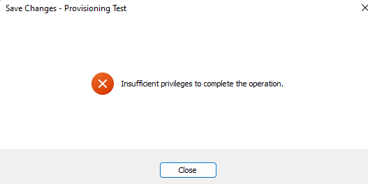

Hi, on further investigation I've discovered that the script is in fact removing the AD groups correctly, however it looks like the script is also enumerating the groups from AAD (I've connected it as a managed domain) and trying to remove the user from 'All Users'. I get the same error when trying to manually remove the user from this group: image.png Is there a way to skip the AAD groups? Cheers, Allister
by (306k points)
Hello Allister,
Yes, it is possible. Use the below script.
$groupNamesToSkip = @("MyGroup1", "MyGroup2", "Department*") # TODO: modify me
function SkipGroup($patterns, $name)
    foreach ($pattern in $patterns)
        if ($name -like $pattern)
            return $True
    return $False
# Get all groups user is a direct member of
$groupGuids = $Context.TargetObject.GetEx("adm-DirectMemberOfGuid")
# Get the Primary Group ID
$primaryGroupId = $NULL
if ($Context.TargetObject.DirectoryType -eq 1)
foreach ($groupGuidBytes in $groupGuids)
    # Bind to the group
    $groupGuid = New-Object "System.Guid" (,$groupGuidBytes)
    $groupGuid = $groupGuid.ToString("B")
    $groupPath = "Adaxes://<GUID=$groupGuid>"
    if ($group.DirectoryType -eq 1)
        # Skip Primary Group
        $groupName = $group.Get("sAMAccountName")
    # Skip special groups
    if (($groupNamesToSkip -ne $NULL) -and
        (SkipGroup $groupNamesToSkip $groupName))
    # Remove user from the group
by (50 points)
Thanks, that's worked
