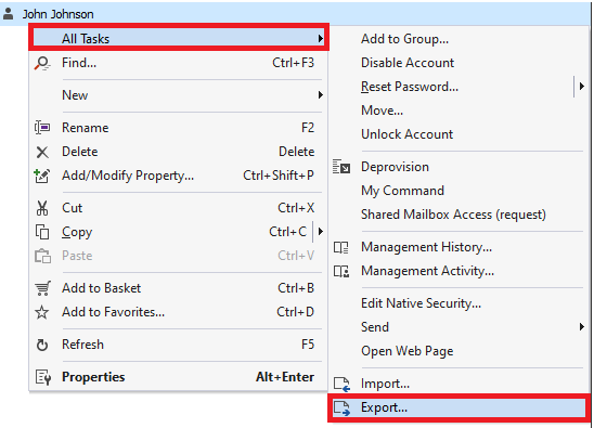

  3. Navigate to and right-click the user.
  4. In the context menu, navigate to All Tasks and then click Export. image.png

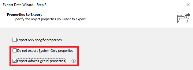

  8. Click Export.
