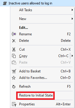

Do we understand correctly that you upgraded to Adaxes 2023 with restoring your Adaxes configuration from a backup? If that is correct, you need to restore the report to its initial state: image.png

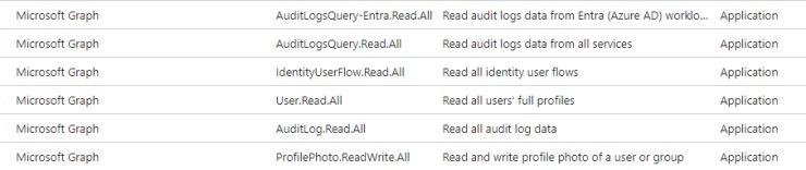

I was able to figure this out and implement it in Adaxes. You'll want to make sure you have these permissions in your enterprise application for Adaxes in Azure. They have to be Application, not Delegated.
Once this is done the last logon timestamp attribute appeared for the Azure users in Adaxes.
Hope this helps!
