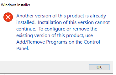

When I start the installation process on the the Adaxes server I get this: image.png
So I have to uninstall Adaxes (old version) to install the new? Why wouldn't this be an in-place upgrade? Will I have to do this everytime a new version comes out? Am I starting the process off incorrectly?
by (1.2k points)
Yes, to upgrade Adaxes, it is required to uninstall the current version and install the new one. For step-by-step instructions, have a look at the Upgrade section of our installation guide: https://www.adaxes.com/help/InstallationGuide/#upgrade.
We have plans to implement the in-place upgrade feature, but it is currently not there.
