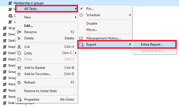

Hello Jonny,
You can use a built-in report, Membership in groups. By default, the report is located in container Reports\All Reports\Groups\Membership. image.png

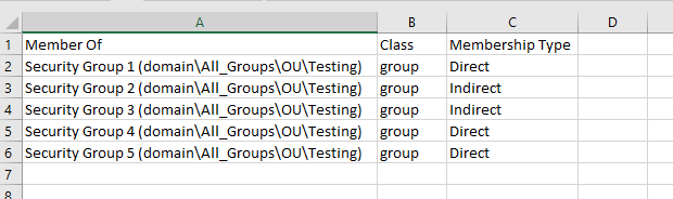

Sure thing!
Example CSV I am looking for: image.png
