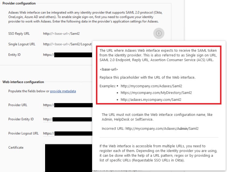

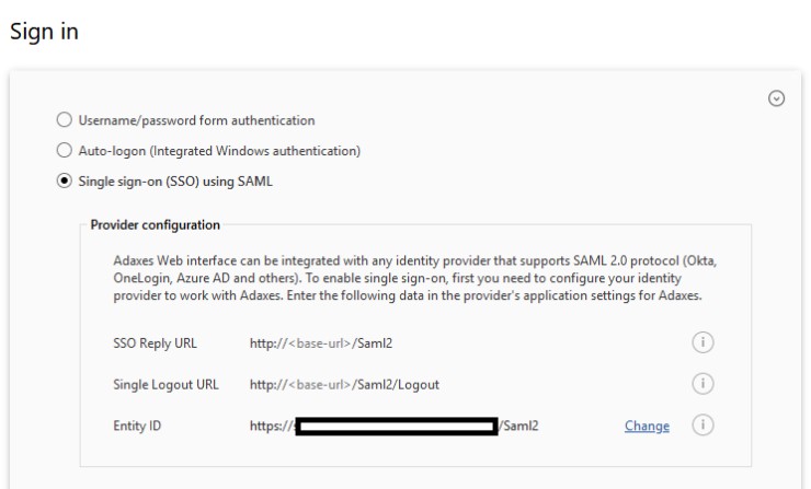

Hi all, so i tried to setup AD FS as IdP with Adaxes as SP. I used this guide: https://www.adaxes.com/help/EnableSamlBasedSingleSignOn/
Sadly i run into error: MSIS3200 which is caused by a missing Assertion Consumer Service.
AD FS is forcing https but the SSO Reply URL from Adaxes is in http. AD FS won't
I can't find a way to change this URL to use HTTPS. (Will attach Screenshot for clarification)
Also the Information field shows that i should be able to change the SSO Reply URL. But unlike with the Entity ID there is no "Change" field.
I checked this question: https://www.adaxes.com/questions/9524/saml-response-reply-url-http-instead-https-due-ssl-offloading?show=9524#q9524
But in my case there is only my AD FS Server and Adaxes. No SSL Offloading or Big IP.
Hope somebody can point me in the right direction!
Bests, Daniel.
by (190 points)
Hello Daniel,
The SSO Reply URL and Single Logout URL you see in the Web interface configurator are just examples of what should be used. For the whole thing to work, you need to enable HTTPS for Adaxes Web interface and then specify the corresponding URLs in AD FS when configuring SAML SSO. You can configure SSL on the Adaxes Web interface the way you do it for any other website hosted by IIS. For details on how to enable SSL for an IIS Web Site, see the following article: https://docs.microsoft.com/en-us/troubleshoot/iis/enable-ssl-all-customers.
