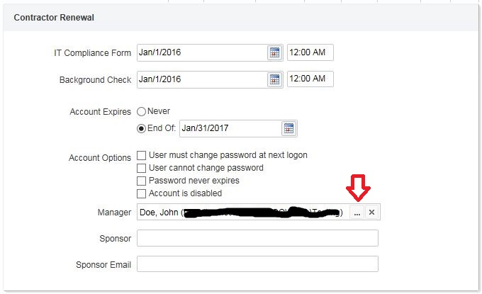

I would like to add a CustomAttribute for a Sponsor field for Contractors that is similar to the Manager field where you can do a user lookup from the Web Console to select the user.
From there, I would like to create a Business Rule to update the extensionAttribute9 field with the email address of the Sponsor.
We do not want to use the Manager field for various reasons such as wrong Org Chart information etc.

I would like to have a CustomAttribute field "Sponsor" that is similar to the "Manager" field where you can click the "..." to select the user.
From there, I would like to have a Business Rule to update the account's extensionAttribute9 (friendly name "Sponsor Email") with the Sponsor's email address.
Here is a working sample that works using the "Manager" field, but I would rather not use the Manager field due to some of our other systems using this field, for example an Org Chart.
I am not sure if a CustomAttribute field can be configured this way, but I found that the Secretary and Assistant fields can. I think I can use the Secretary field, but would rather not use the Assistant field as it shows in the GAL.

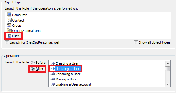

  3. On step 2 of Create Business Rule wizard select User Object Type.
  4. Select After Updating a User and click Next.

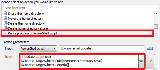

  5. Click Add Action and select Run a program or PowerShell script.
  6. Enter a short description and paste the following script into the Script field:
     $sponsorDNAttribute = "secretary" # TODO: modify me
     $sponsorMailAttribute = "extensionAttribute9" # TODO: modify me
     # Get sponsor DN
         $sponsorDN = $Context.TargetObject.GetEx("secretary")
         return # Sponsor not specified
     if ($sponsorDN.Length -gt 1)
         $Context.LogMessage("More than one sponsor is specified", "Warning")
     $sponsor = $Context.BindToObjectByDN($sponsorDN[0])
     # Get Sponsor Email address
         $mail = $sponsor.Get("mail")
         $Context.LogMessage("Sponsor email address not specified", "Warning")
     # Update target user
     $Context.TargetObject.Put($sponsorMailAttribute, $mail)

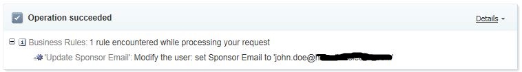

  7. Click OK and then double-click the operation succeeded.

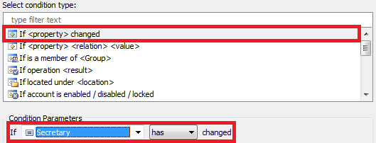

  8. Select If changed.
  9. Select If Secretary has changed, click OK and then click Next.

Thanks Guys! It works great!
