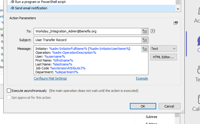

When I put more than one address in here I get an error if I use a semicolon it will save but doesn't email the second address. I have set my automation to use a separate action for each email address but thought that was cumbersome to manage. What might I be doing wrong?

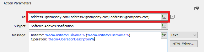

Using the below approach (semicolon and a space) should work just fine to specify multiple recipients. image.png If you face errors/warnings in this case, please, provide us with screenshots. You can post them here or send to us at support@adaxes.com.
by (1.2k points)

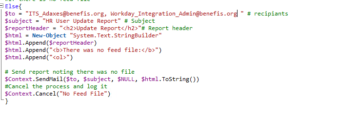

+1
Have a look at the example in the method description: https://www.adaxes.com/sdk/ExecuteScriptContextClass/#SendMail_details. Your approach is absolutely right.
