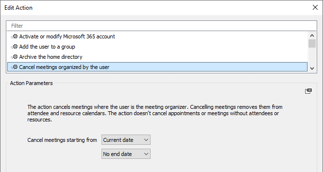

There is no need to use scripts any longer. You can use the dedicated action: image.png

I've come across another issue with the script and also the new built-in action for cancelling meetings. Meetings that are created by a user in a Teams channel do not get cancelled. Is there a known way to cancel those meetings as well?
Hello David,
The behavior is by design. Unfortunately, there is no such built-in functionality in Adaxes. It should be possible using a script, but we do not have anything like that .
