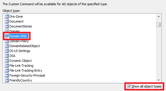

  2. On step 3 of the Create Scheduled Task wizard, select Show all object types, then select Domain-DNS.

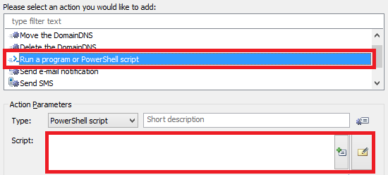

  3. Add the Run a program or PowerShell script action and paste the script from the repository.
  4. Modify script parameters, add a short description and click OK.

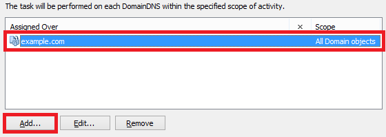

  5. Click Next. On this step, click Add and select any AD domain. The selected domain will be used only to trigger execution of the PowerShell script and will not affect the scope of log reports included in the report.
  6. Click OK two times, and then click Finish.
