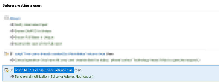

I am using this in the 'Before user creation' area: image.png

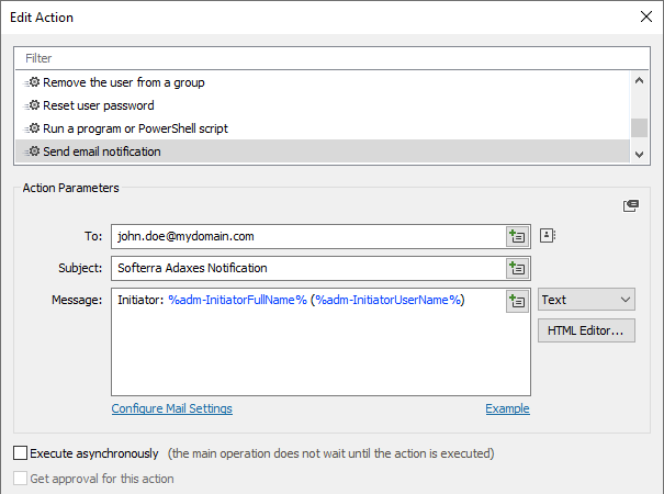

Thank you for specifying. For further troubleshooting, please, post here or send us at support@adaxes.com the following:
  • A screenshot of the Send email notification action configuration. We need something like this: image.png

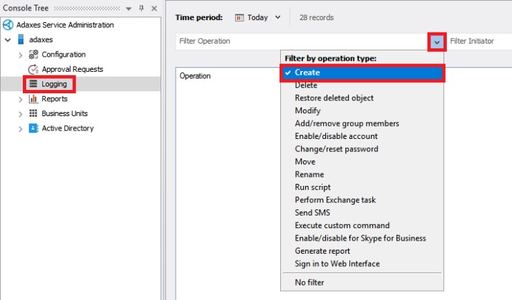

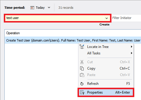

  • A screenshot of the Create user operation Execution log. To take the screenshot:
    1. Launch the Adaxes Administration console.
    3. Select Logging.
    4. In the Result Pane on the right, select the required Time period (e.g. Today if the user was created today).
    5. Click the down arrow embedded into the Filter Operation field.
    7. In the Filter Operation field, type the name of the user you created.
    8. Right-click the log record for the Create user operation and then click Properties. image.png
    9. Resize the Log Record Properties window to fit all Execution log records.
    10. If the execution log is too big to fit a screenshot, select all records using Ctrl+A, copy them and send to us in TXT format.

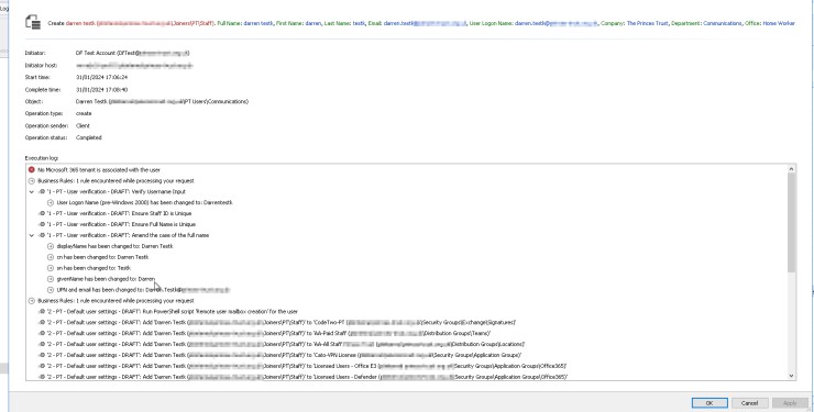

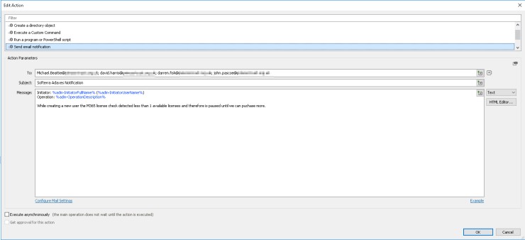

by (110 points)
Here are the screenshots as requested.
by (17.0k points)
+1
Thank you for the provided screenshots. According to the very first error in the Execution log, the account is created in the container that is not included into the Associated Directory Scope of the Microsoft 365 tenant registered in Adaxes.

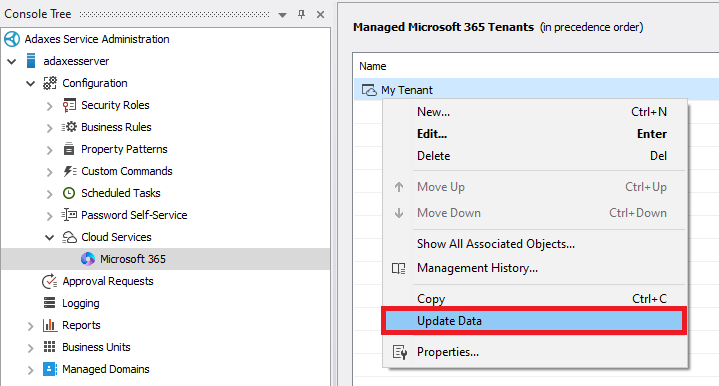

I also use the above script and it usually works very well, only when I have freshly cleaned up the license pool it takes about 2h until the check is up to date again. Can I also achieve a faster update in Adaxes?
Hello Boris,
The easiest way is to just update Microsoft 365 tenant data manually after the changes to licenses/services are made: image.png As another option, you can update parameter O365.UpdateTenantDataPeriod as described in the following article: https://www.adaxes.com/help/ChangeConfigurationParameters.
by (570 points)
Thanks for the link, exactly what I needed. Perfect.
