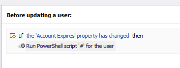

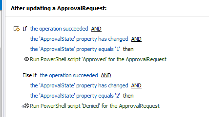

Ok, how can I identify the outcome? Which property do I need to check for approve and which for deny?
You can use the ApprovalState property in the business rule. 1 is for approved and 2 is for denied. image.png

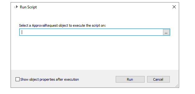

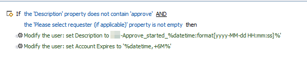

A scheduled task is running on this BU and changes the accountExpire to +6 months and sets the description to "approve started" image.png

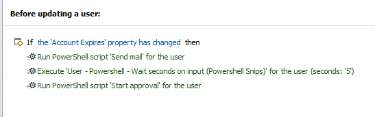

Now my business rule is triggered (before updating user) and checks if the accountExpire was changed (scope to same BU) If yes, I send an email with information and a approval via PowerShell is started image.png
$approvers = @("%adm-CustomAttributeObject2%")
$Context.SubmitForApproval($approvers, $false, $false, $false, $false)

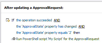

If I understand it correctly, the above condition check from you, needs to be added here as action "if powershell script returns true"?
Yes, that is correct. The script has to be added via the If PowerShell script returns true condition.
