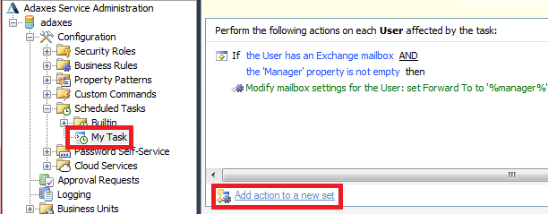

Also, I'd like to see if the following is possible (please see the screenshot)
The rule is: If there is a manager, set forwarding to the manager.
How can I add: If there is no manager, e-mail IT and notify the team that forwarding was not set. (unless there is a better method to achieving this, some kind of output log of the tasks completed on the deprovisioned user)..

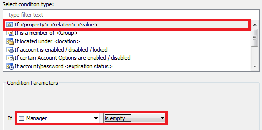

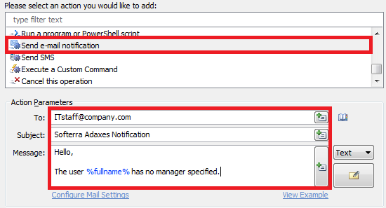

You can achieve this by adding another set of actions and conditions to the Scheduled Task. To do so:
  2. Navigate to Configuration\Scheduled Tasks and select the task.
  3. Click Add action to a new set in the Result Pane.
  4. Select Send e-mail notification.
  5. Specify Action Parameters and click OK.
  6. Double-click Always.
  7. Select If <property><relation><value>.
  8. Select If Manager is empty.
  9. Click OK and save the changes.
