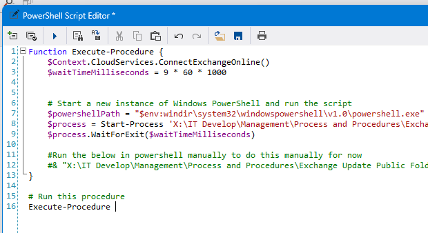

The full script is as below:
Function Execute-Procedure {
    $Context.CloudServices.ConnectExchangeOnline()
    $waitTimeMilliseconds = 9 * 60 * 1000
    # Start a new instance of Windows PowerShell and run the script
    $powershellPath = "$env:windir\system32\windowspowershell\v1.0\powershell.exe" #"C:\Windows\System32\WindowsPowerShell\v1.0\powershell.exe"
    $process = Start-Process 'X:<filepathreadacted>PowerShellQuery.ps1' -NoNewWindow -ArgumentList ("-Users %username% -AccessRights PublishingEditor -IncludeFolders '\%param-SelectedFolder%' -Recurse -Confirm:$false") -PassThru
    $process.WaitForExit($waitTimeMilliseconds)
    #Run the below in powershell manually to do this manually for now
    #& "X:<filepathreadacted>PowerShellQuery.ps1" -Users %username% -AccessRights PublishingEditor -IncludeFolders "\%param-SelectedFolder%" -Recurse -Confirm:$false
# Run this procedure
Execute-Procedure

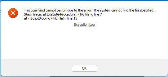

The error is as shown
Line 7 being the powershell launch line:
At first, I thought it was the ps1 file being on a network location but after swapping it to a local location and looking closer at the error, it is the powershell launch line that is the error.

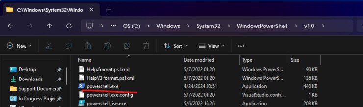

Powershell is indeed in that location however:
I've restarted Adaxes service and my PC, yet the issue remains. Even launching the custom command with only the launch line and no other commands, it is still the error of can't find file or path. But I can launch it from this location using command prompt.

The $powershellPath variable is not used anywhere in the script so you can just remove the corresponding line. At the same time, it is generally not required to force Adaes to start/import PowerShell or anything of the kind. Additionally, we recommend you to just place the full code into the Adaxes action rather than storing it in a file. The main reason is that such scripts are no part of Adaxes functionality and require additional maintenance.
