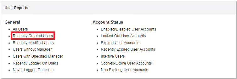

  2. Click Reports in the top navigation menu.
  3. At the Reports page, click the Recently Created Users report.

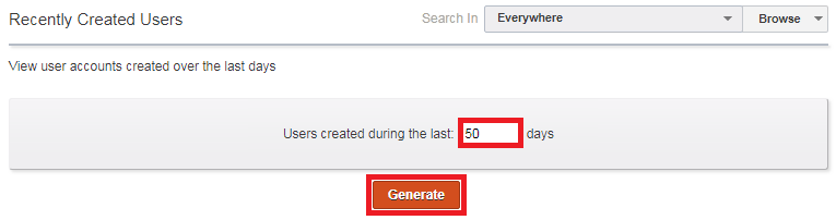

  4. Specify the number of days for which you want the created user accounts to be shown and click Generate.
  5. Copy the link to the report from your browser’s address bar.

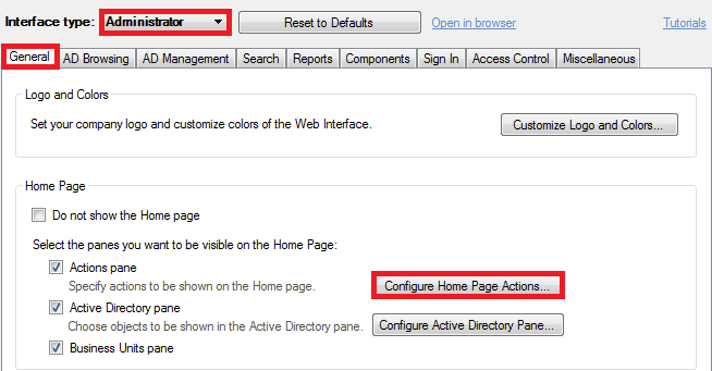

  7. Launch Adaxes Web Interface Customization Tool.
  8. Select the interface type and click Configure Home Page Actions on the General tab.

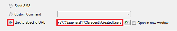

  9. Click Add and select Link to Specific URL.
  10. Paste the link with doubled percent signs.
  11. Click Next and finish creating the Home Page Action.
