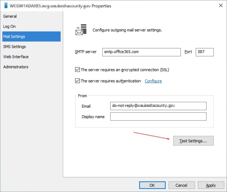

After following the process outlined at https://www.adaxes.com/help/ConfigureMailSettings/#exchange-app-auth, I enter in the smtp server, port 587, the server requires authentication, Microsoft Entra App credentails, Application (client) id, Directory (tenant) id and client secret. When I try to click Ok or Test Settings, the admin console hangs and eventually crashes. I am confident I have the service princiapl setup with the permissions correctly.
Is there anywhere I can troubleshoot or see a log of what is causing the console to crash? I checked the event viewer, nothing. Checked the adaxes logging, nothing.

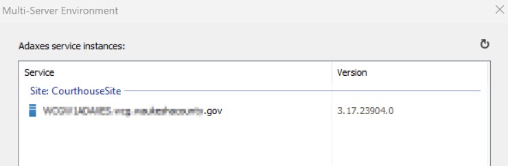

For troubleshooting purposes, please, provide a screenshot of the mail settings you configured. Also, please, provide us with a screenshot of the Multi-server environment dialog. The dialog displays how many Adaxes services you have and what their versions are. For information on how to view it, see https://www.adaxes.com/help/MultiServerEnvironment. You can post the screenshots here or send to us at support@adaxes.com.

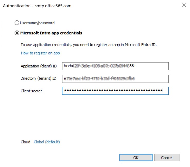

When I ran the PowerShell from the reference link, I made sure to give the service principal full access to the do-not-reply mailbox and ensure that the mailbox is licensed. When I click the "test settings" or ok, that is when the console crashes and the settings do not save. I have tried with the SSL setting check and unchecked. Results were the same.
I have been able to verify the sucessful login using the client secret with the service principal in Entra id logs.
