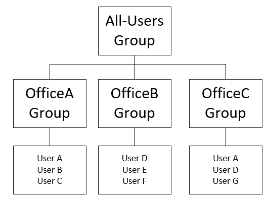

We have groups that have nested groups that have members.
(How our nested groups are setup. One user can be part of more than on group.)
I need one CSV with name and email address created of all the users in the highest level group emailed to me.

I need the in-direct members because the "All-Users" group does not contain users directly only the groups for the offices they are in. The office groups contains the users. Also I need one CSV, that script makes a new CSV for each nested group. which is not what I need. I need the user's name and email address only in the CSV
