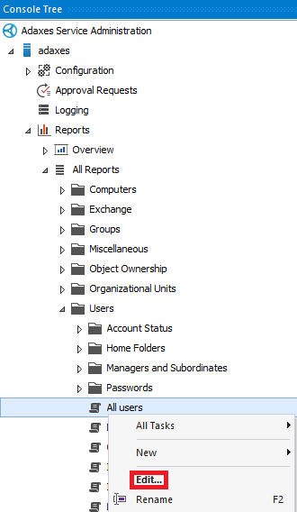

  2. In the Console Tree, expand the service node.
  3. Navigate to Reports/All reports/Users and right-click the All users report.
  4. In the context menu, click Edit.

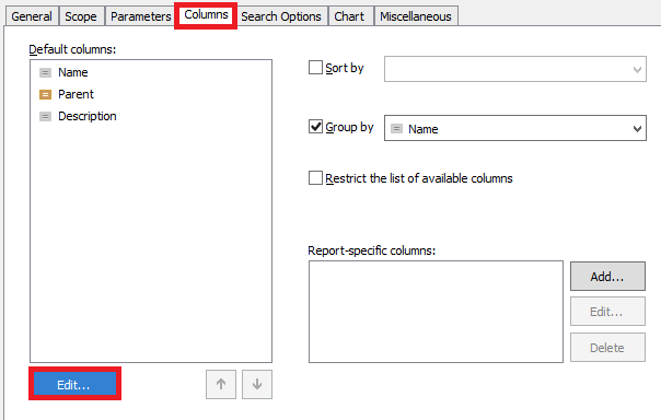

  5. Activate the Columns tab and click Edit below the Default columns section.

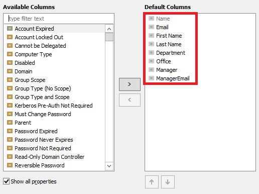

  6. Add the columns you need to the Default Columns list.

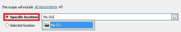

If you want to create a separate report for users only in the specific OU, do the following:

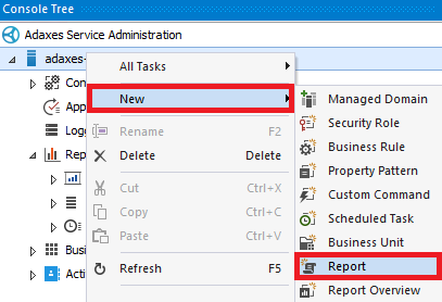

  2. In the Console Tree, right-click your service node, navigate to New and click Report.
  3. Enter a report name and select Active directory search.
  4. Click Next and then click New.

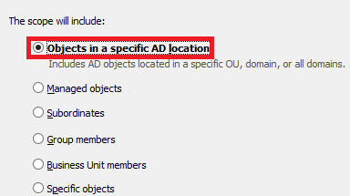

  5. Select Objects in a specific AD location and click Next.
  6. Specify the Title and Drop-down item text, and click Next.
  7. Select Specific location.
  8. Type the name of the OU you need and press Enter.
  9. Click Finish and then click Next twice.
  10. Click Edit below the Default columns section.
  11. Add the columns you need to the Default Columns list.
  12. Click OK.
  13. Optionally, specify sorting and grouping setting and click Next.

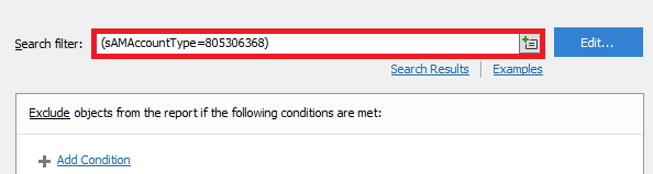

  14. In the Search filter field, enter the following:
    (sAMAccountType=805306368)
  15. Click Next twice.
  16. Select categories for the new report and click Finish.
Ok, thanks. I see where my issue was. I created a report, and selected Manager Email, which isn't the right field. It's ManagerEmail wthout spaces. Thanks for timely help!
