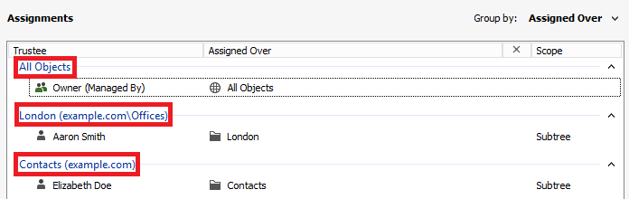

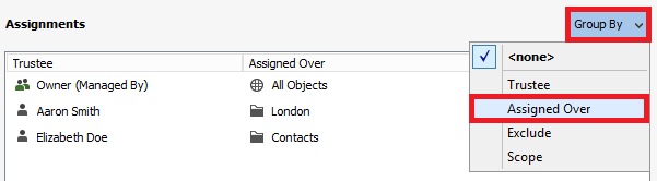

As a workaround, you can enable grouping assignments by the Assigned Over column. In this case, you will see the path for the objects in the group header.
To enable the grouping:
  3. Navigate to Configuration\Security Roles and select the role you need.
  4. In the Assignments section, expand the Group By drop-down list and click Assigned Over.
