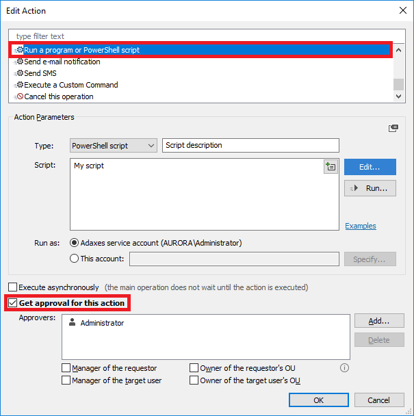

If you want to send execution of an action (e.g. Run a program or PowerShell script) for approval, you can use option Get approval for this action. In this case the action will not be executed until approved.
