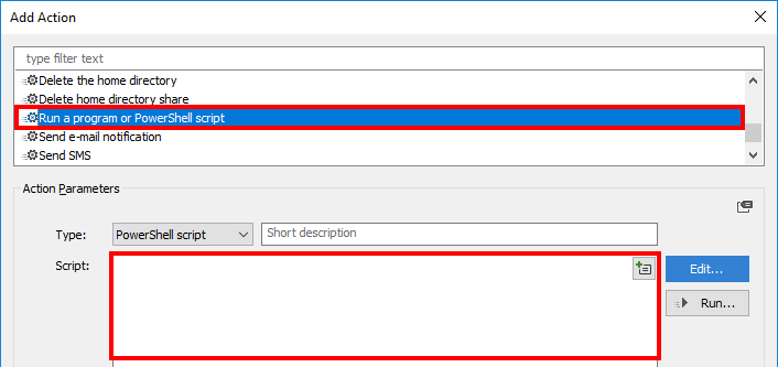

If the issue persists even on a separate server with the default configuration of Adaxes, most probably, it is related to your environment. To troubleshoot the issue, you should check Event Log for related errors on the Domain Controller (DC) Adaxes is connected to. To find out which DC Adaxes is using for a domain, you can create a Custom Command as follows and execute it on any user from the domain you need. The DC will be displayed in the ​Execution Log after the command completes.
To create the Custom Command:
  3. In the context menu, navigate to New and click Custom Command.
  4. On step 2 of the Create Custom Command wizard, select User object type and click Next.
  5. Click Add an action.
  6. Select Run a program or PowerShell script and paste the following script into the Script field:
     $rootDSE = $Context.BindToObject("Adaxes://$domainName/rootDSE")
     $domainControllerFQDN = $rootDSE.Get("dnsHostName")
     $Context.LogMessage("Domain Controller: $domainControllerFQDN", "Information")
  7. Enter a short description and click OK.
  8. Click Next and finish creating the Custom Command.
