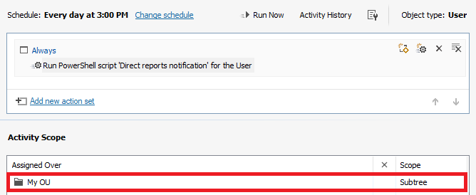

Hello Kaj,
The script should be executed on User objects. For the Scheduled task that runs the script to send notifications only to managers in a specific OU, you need to add the OU to the Activity Scope of the task as subtree. The Scheduled Task will look like the following:
