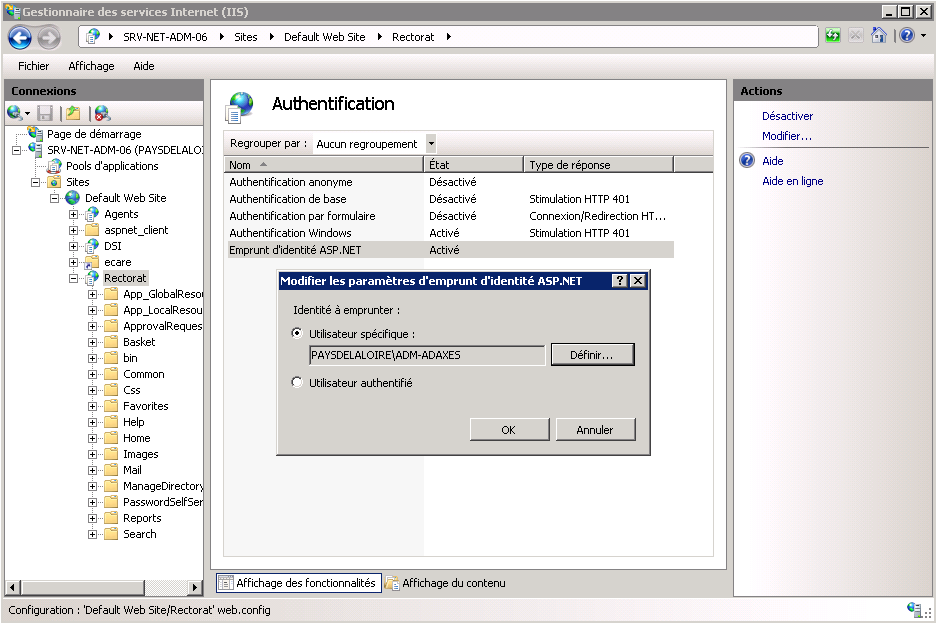

I've got a problem with Windows Authentication in web interface.
When I am in Form Authentication, there is no problem.
If I change for Windows Authentication, I am correctly identified and logged but after that, I don't have any permission on AD, even to read.
Screenshots will be better than my english...
Thanks for your help
Yoann HAMON
Windows authentication :
(Windows authentication)
Form authentication :
(Form authentication)

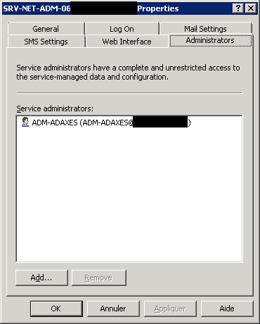

It looks like your Adaxes Web Interface and Adaxes Service are installed on different computers. If it is so please follow the steps below to fix the issue:
  • On the computer where Adaxes Web Interface is installed open the file C:\Users\All Users\Softerra\Adaxes 3\Softerra.Adaxes.Adsi.dll.config
  • Find the element <channel ref="tcp" priority="2" secure="true">
  • Add the following attribute to this element: <channel ref="tcp" priority="2" secure="true" servicePrincipalName="username@domain.com">, where username@domain.com is the username of the Adaxes Service Default Administrator (the user that was specified during the Adaxes Service installation).
  • Save the file.
  • Restart the IIS.

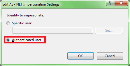

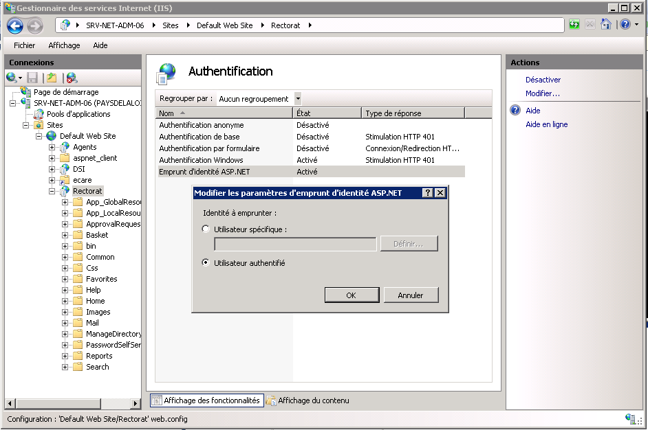

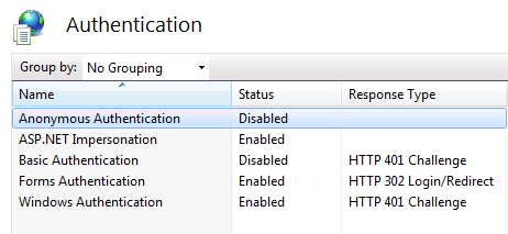

The correct IIS authentication options for Adaxes Web Interface are as follows:
  • Anonymous Authentication: Disabled
  • ASP.NET Impersonation: Enabled
  • Basic Authentication: Disabled
  • Forms Authentication: Enabled
  • Windows Authentication: Enabled
    See this screenshot for details:

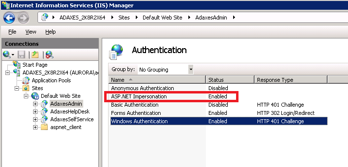

    It is important that ASP.NET Impersonation is set up to impersonate as the Authenticated user:
Make sure that the servicePrincipalName attribute is not specified in the Softerra.Adaxes.Adsi.dll.config file. If it is still there, remove it.
Restart IIS, restart your browser and try again.

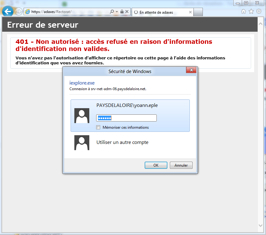

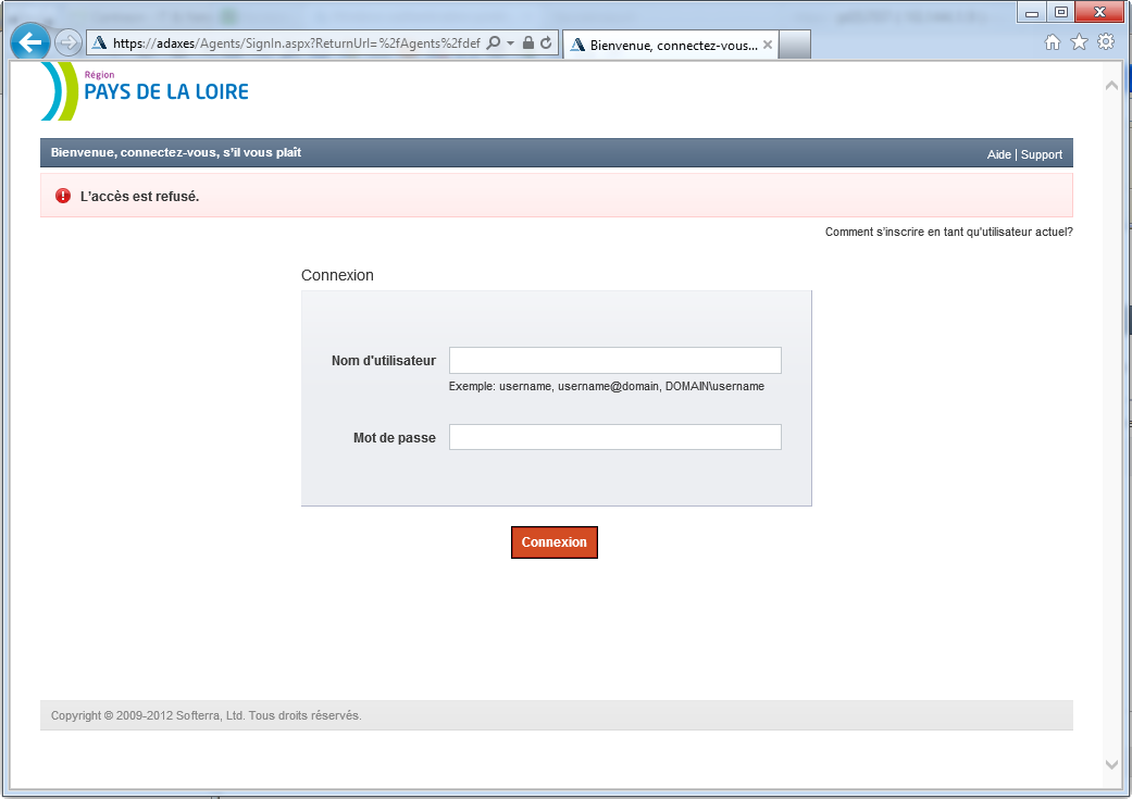

In this case, I have a refused access on first try (when I've just open my browser).
If I insert my username et password in forms, it's OK.
It happens because Integrated Windows Authentication fails to use the Kerberos protocol and switches to the NTLM protocol. This Microsoft KB article describes your issue https://support.microsoft.com/en-us/hel ... ion-issues
To troubleshoot this issue first of all ensure that the account of the computer where Adaxes Web Interface is installed is trusted for delegation, for details please see the following link: http://adaxes.com/help/UsingWebInterfac ... #id1110516
Next question, are you connecting to the Adaxes Web Interface using the actual NetBIOS name of the server or an alias name?
Your last question helped me! Indeed, I use a DNS alias and I had to register it as additional SPNs on the server.
I used this Microsoft guide : http://blogs.msdn.com/b/webtopics/archi ... s-7-0.aspx.
This time, everything seems to work.
However, I think you should add that ASP.NET Impersonation must be activated in the process of implementing integrated authentication. And perhaps talk about this SPN when using a DNS alias.
