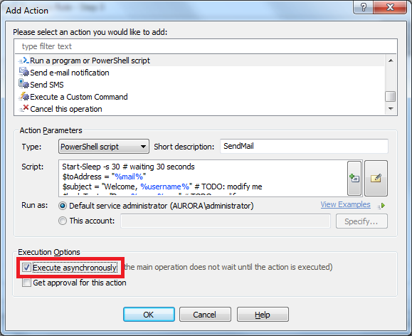

We suggest that you send your email in a PowerShell script. This script allows you to 'pause' the operation:
  1. Add the Run a program or PowerShell script action to your Business Rule.
  2. In the Add Action dialog, enable the Execute asynchronously option.
  3. Type the following PowerShell script:
     Start-Sleep -s 30 # waiting 30 seconds
     $toAddress = "%mail%"
     $subject = "Welcome, %username%" # TODO: modify me
     $bodyText = "Dear %name%, ..." # TODO: modify me
     $bodyHtml = "Dear <b>%name%</b>, ..." # TODO: modify me
     $Context.SendMail($toAddress, $subject, $bodyText, $bodyHtml)
