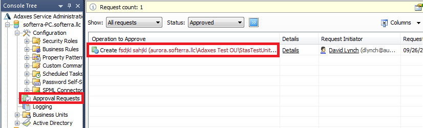

First, you may view approved Approval Requests not in the Adaxes Service Log, but in the Approval Requests node of the Console Tree. See this help article on how to access this feature: Managing Approval Requests. This feature shows the target object of the approval request:

Thats a great sarting poing, i had not realised that you could view previous approvals requests.
My issue with that methos is as the list gros there isnt any filtering options that i can see so we can easily extract the approvals for specific groups. Would the PS script just log it to the Adaxes log or would this just be a way to extract the info from Adaxes when an access report is needed for SOX auditing etc.
by (18.0k points)
You can extract only the data you need. For more details have a look at Managing Approval Requests.
