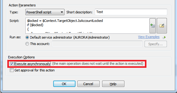

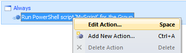

You can configure your Custom Command to execute the PowerShell script asynchronously:
  1. Right-click your 'Run script' action and select Edit Action in the context menu.
  2. Enable the Execute asynchronously option for the action.
  3. Save the changes.
by (520 points)
That worked quite well. Thank you.

I also have a script that takes a while to run. I have tried running it asynchronously but Adaxes still times out after 10 minutes and then the script never completes. Is there any way to increase the time that Adaxes waits for the process to finish?
Hello Stuart,
The thing is currently in Adaxes we have a limitation of 10 minutes, during which a PowerShell script should complete. If a script fails to complete within 10 minutes, the operation is cancelled. Currently there is no setting or configuration entry that you can use to increase the time limit.
It is quite strange that a PowerShell script cannot complete in 10 minutes. 10 minutes in more than enough for a PowerShell to complete. Probably, the best way to resolve this issue would be to optimize the script. Can you describe what the script does or send the script to our support email (adaxes@softerra.com)?
