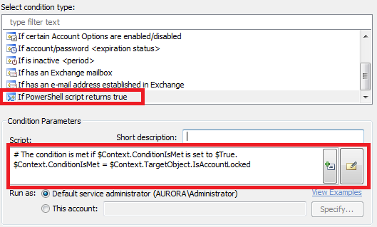

As for checking if an account is locked, there is no built-in condition to check if an account is locked, but you can use the If PowerShell script returns true condition for this purpose.
To add such a condition to your Scheduled Task:
  1. Right-click the set of actions and conditions of your Scheduled Task.
  2. Click Add Condition....
  3. Add the If PowerShell script returns true condition and paste the following script:
     $Context.ConditionIsMet = $Context.TargetObject.IsAccountLocked
The script uses the IsAccountLocked property of the user object. As an option, you can use it in your own script, for example:
$isAccountLocked = $Context.TargetObject.IsAccountLocked
if ($isAccountLocked)
  # TODO: add some code here.

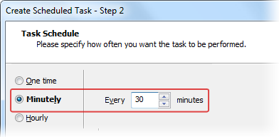

The minimum time interval for a Scheduled Task is once an hour.
Starting from Adaxes 2013.1, Schedules Tasks can be set up to run every N minutes.

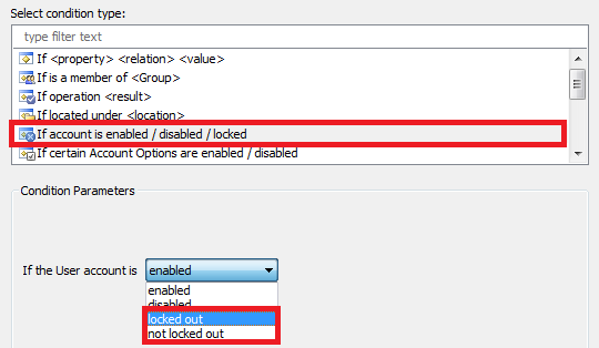

Also, now you don't need a script to checked whether an account is locked out. Use the If account is locked out / not locked out condition.

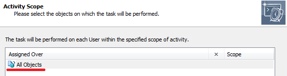

How would I check every single user in my AD?
Would I just created a for-each loop...? Would anyone mind posting code that does this?
Hello Michael,
The posts in this topic suggest that you create a Scheduled Task. On the final step of the Create Scheduled Task wizard, you are supposed to specify an Activity Scope for the task. A Scheduled Task Activity Scope defines the objects for which the task will be run. If you include All objects in the Activity Scope of a Scheduled Task created per the above instructions, this will mean that the task will run for each user account in your Active Directory. In other words, it will check each user.
