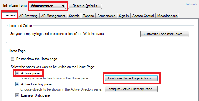

I. To create the Home Page Action:
  1. On the computer, where your Web Interface is installed, start the Web Interface Customization tool.
  2. In the Interface type drop-down list, select the Web Interface that you want to configure.
  3. Activate the General tab, select the Actions pane option, and click Configure Home Page Actions.
  4. In the Home Page Actions dialog that appears, click Add...
  5. On the 1st step of the Add Home Page Action wizard, Switch the radio button to Add to Group.
  6. On the 2nd step, specify the name for the Home Page Action, for example, Relocate Branch.

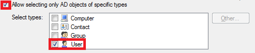

  7. On the 3rd step, select the Allow selecting only AD objects of specific types option and User.

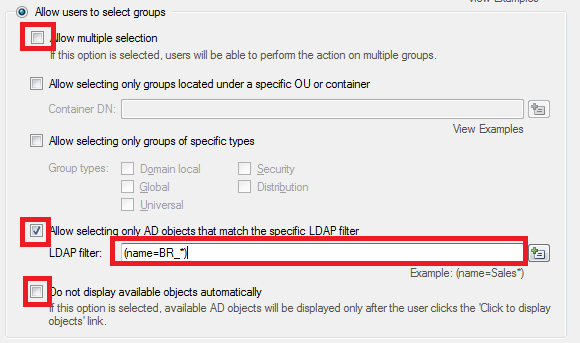

  8. On the 4th step, uncheck the Allow multiple selection and Do not display available objects automatically options.
  9. Select the Allow selecting only AD objects that match the specific LDAP filter option.
  10. Specify the following LDAP filter: (name=BR_*).
  11. Click Finish.
  12. Click OK.

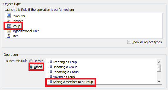

II. To create the Business Rule:
  1. Launch Adaxes Administration Console and create a new Business Rule.
  2. On the 2nd step of the Create Business Rule wizard, select Group and After Adding a member to a Group.

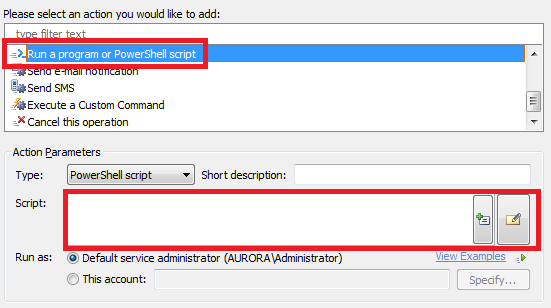

  3. On the 3rd step, click Add Action.
  4. In the Edit Action dialog that appears, add the Run a program or PowerShell script action.
  5. In the Script area you need to add a script that would check if the user is already a member of a any groups starting with BR_ and remove the user from those groups.
    Here's an example of such a script:
     $newMemberDN = "%member%"
     $newMember = $Context.BindToObjectByDN($newMemberDN)
         $memberOf = $newMember.GetEx("memberOf")
     foreach ($groupDN in $memberOf)
         # Skip the new group
         if ($groupDN -ieq "%distinguishedName%")
         if ($group.Name -match "BR_*")
             $group.Remove("Adaxes://$newMemberDN")
  6. When finished with the script, write a short description for it and click OK.
  7. Double-click Always.

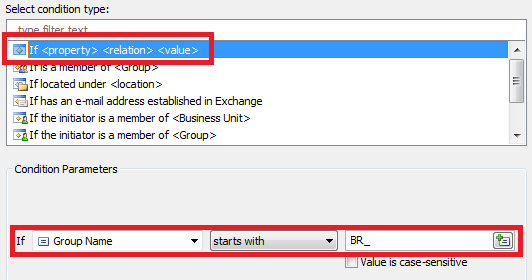

  8. In the Add condition dialog that appears, select the If condition.
  9. Select If Group Name starts with and type BR_.
  10. Click OK and finish creation of the Business Rule.

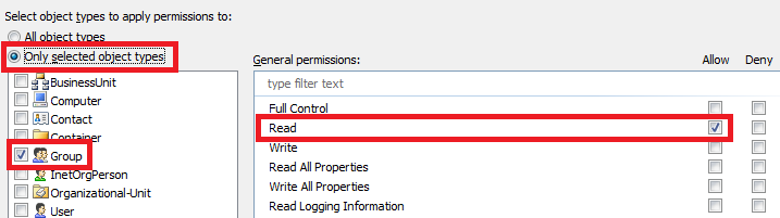

As to the error that you get, the account that you are testing with is not granted the permission to read Group objects. To grant such a permission:
  2. Open your Security Role that grants the Write permission.
  3. Right-click in the Permissions area and click Add...
  4. In the Add Permissions dialog that appears, switch the radio button to Only selected object types and check Group.
  5. Select the Read permission in the Allow column.

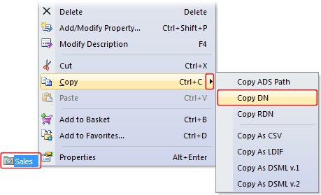

To get the DN of an Active Directory object:
  1. Launch the Adaxes Administration Console.
  2. Right-click the object you need.
  3. In the context menu, open the submenu of the Copy item.
  4. Click Copy DN. The DN of the selected Active Directory object will be copied to the clipboard.
