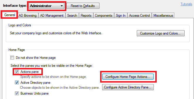

To create the Customized Home Page Action:
  3. Activate the General tab, select the Actions pane option, and click Configure Home Page Actions.
  4. In the dialog box that appears, click Add...

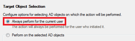

  7. On the 3rd step of the wizard, select Always perform for the current user to evade the object selection page.

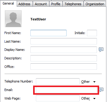

$smtpTo = $Context.Initiator.UserAdsObject.Get("mail")    # To send emails to the operation initiator

by (350 points)
I'm receiving the following error. Can you assist with this?
Run PowerShell script 'Exchange Health Check' for the user
Exception calling "Get" with "1" argument(s): "The 'mail' property cannot be found in the cache." Exception calling "SendMail" with "4" argument(s): "Parameter must be a non empty string. Parameter name: toAddress"
Michael,
This error means that the user account with the credentials of which you are trying to launch the Custom Command does not have the Email property specified. The script tries to email the report to this e-mail.
by (350 points)
Thank you that was the issue. The script is working now!
