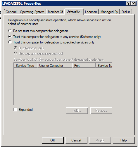

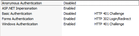

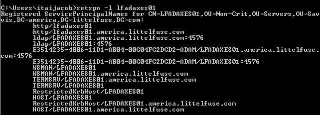

we are running Adaxes on a MS Server 2008 R2 with IIS 7.5 and we wanted to enable Automatic Login for the self-service part.
We did it exactly the way like it is described in the documents and we also did the SPN part but it refuses to work, the only machine where SSO works is on the server itself where Adaxes is installed.
I should note that we have a AD forrest, consisting out of three domains, where the Adaxes server is placed in the root domain.
