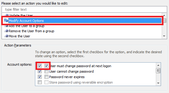

To expire a user's password, you need to set the User must change password at next logon flag in the user's Account Options. This will force the user to change password next the user logs on. To set the flag with the help of a Business Rule, Scheduled Task or Custom Command, you need to add the Modify Account Options action that sets the flag. To do this:
  1. Add the Modify Account Options action to your Business Rule, Scheduled Task or Custom Command.
  2. In the Action Parameters section, check the first and the second checkboxes opposite the User must change password at next logon option.
As to why setting the Password Last Set property to a certain value caused the error, this happens because you are allowed to set the property only to Unspecified (which is the same as setting it to 0). This is the only value that should not cause the error. Setting the value to Never or a certain date will cause the error, because this is reserved to use by the system as per Active Directory design. You are not supposed to set these values manually.
