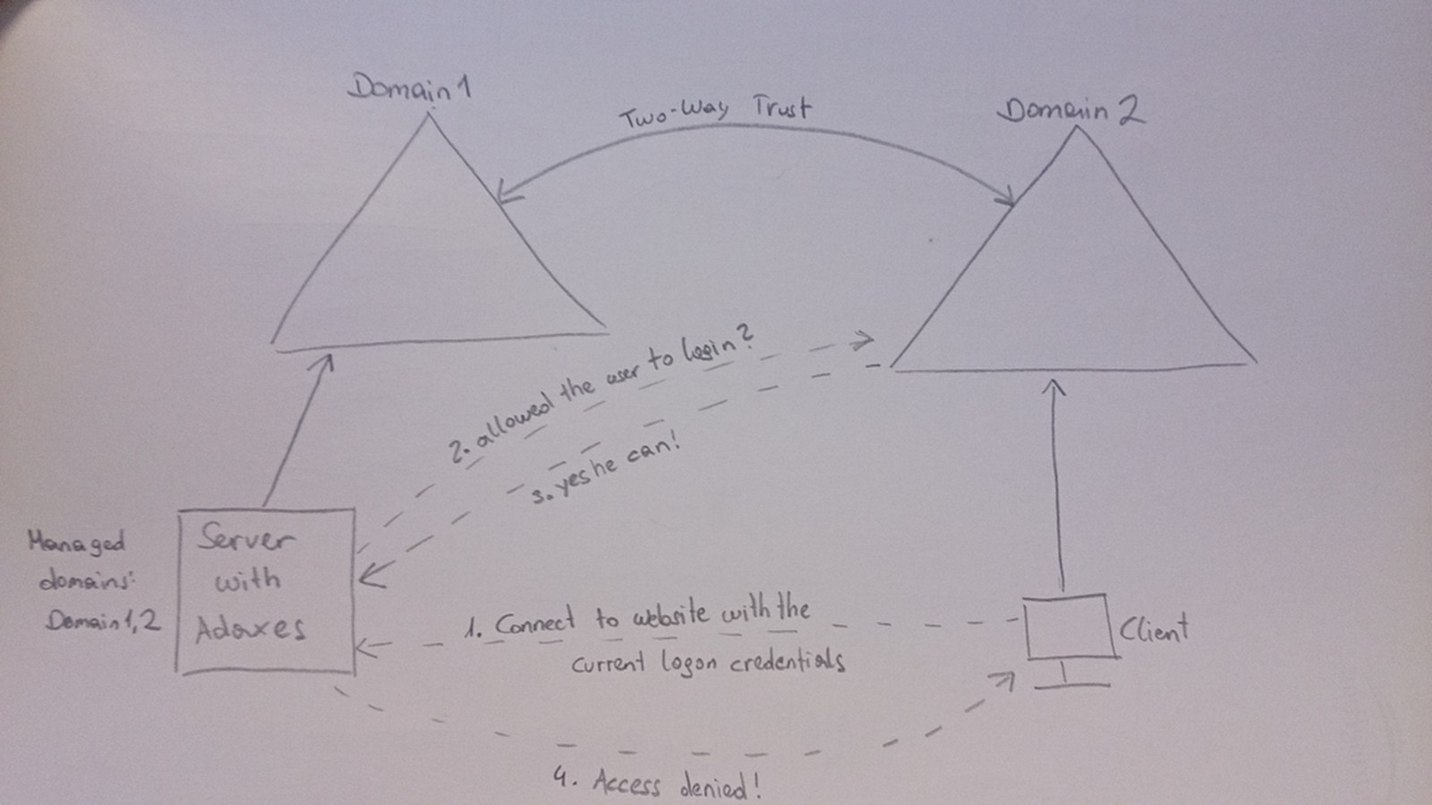

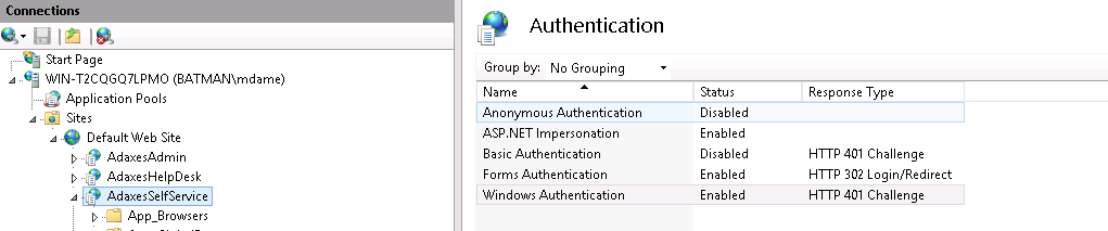

I attach a picture above our server structure and the windows iss settings of the adaxes selfservice site.
We have 2 domains.
in the domain 1 is a server with the adaxes software. (Adaxes managed both domains)
In the domain 2 are the clients.
Between the Domains we have a Two-Way Trust.
Auto Logon is enabled.
When a user opens the website http:///adaxesselfservice the user should be automatically logged in. When the user connects to the site, she gets "access is denied" and has to log in manually.

(ISS Settings)

The IIS authentication options look OK.

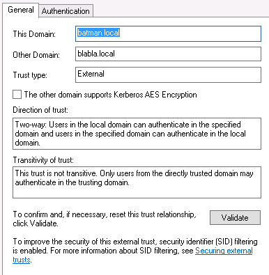

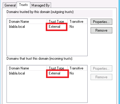

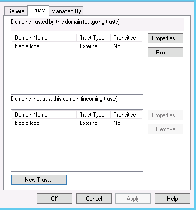

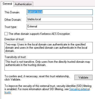

Trust configuration:
Thanks,
Markus
Markus,
The trust type between the domains is External, however it should be a Forest Trust for Kerberos to work.
