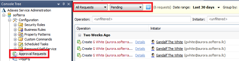

By the way, how many pending Approval Requests do you have? There was an issue in Adaxes that caused Web interface slowdown if there were many pending Approval Requests. It was fixed in Adaxes 2013.1.
To find all pending Approval Requests:
  2. Expand the service node that represents your Adaxes service.
  3. Navigate to Configuration \ Approval Requests.
  4. In the Result Pane (located to the right), select All Requests and Pending.
  5. Click the Apply Filter button.
To remedy the issue with many Approval Requests, you'll need to upgrade. Find the latest build here.
