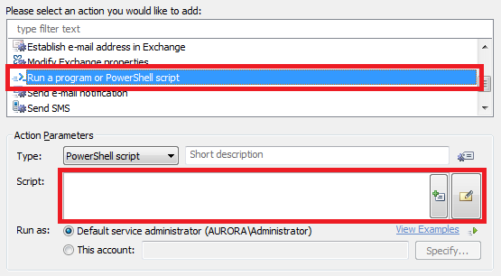

  3. On the 3rd step, add the Run a program or PowerShell script action and paste the following script:
     $strValue = "m:                    d                              " # TODO: modify me
     $binaryValue = [System.Text.Encoding]::UTF8.GetBytes($strValue)
     $Context.TargetObject.Put("msNPAllowDialin", $True)
     $Context.TargetObject.Put("userParameters", $binaryValue)
    The script above sets the msNPAllowDialin property to True, and also modifies the Remote Desktop Settings property.
