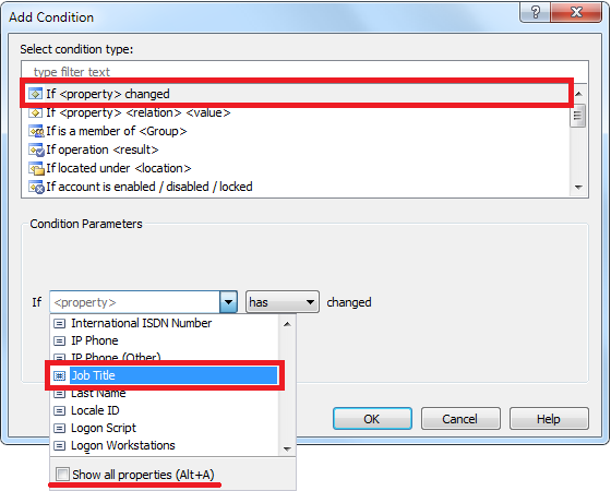

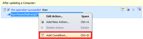

Basically, you need to create a Business Rule triggered after updating a User. In the Actions and Conditions of the Business Rule, you can use the If <property> changed condition type to check whether this or that property has changed. To add such a condition to your Business Rule:
  1. Right-click an action that should be triggered only when a certain property is changed and click Add Condition.

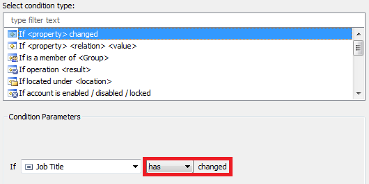

  2. Select the If <property> changed condition type.
  3. In the <property> drop-down list, select the necessary property. If it is not available in the list, check the Show all properties option.
  4. Select has changed.
  5. Click OK.
