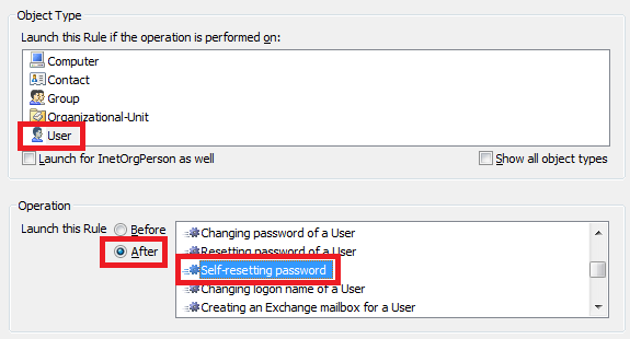

Yes, it's possible to automatically unlock locked users upon self-password reset without enabling the Account Unlocking option. For this purpose, you need to create a Business Rule triggered After self-resetting password that automatically unlocks all locked out accounts. To create such a Business Rule:
  2. On the 2nd step of the Create Business Rule wizard, select User and After Self-resetting password.
  3. On the 3rd step, add the Run a program or PowerShell script action and paste the following script:
