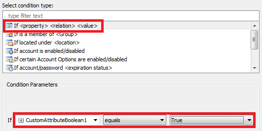

  3. Also, you'll need to run the Business Rule only when the custom attribute is set to True. For this purpose, you need to add a condition. You will find information on how to do this on step 6 of the tutorial. You'll need to specify the following condition: If CustomAttributeBoolean1 equals True.
    where CustomAttributeBoolean1 is the name of the custom attribute you want to use.
