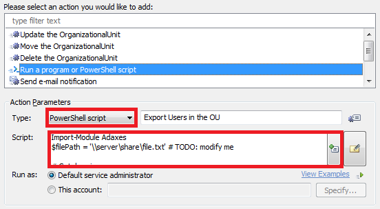

To add the script to your Scheduled Task, use the Run a program or PowerShell script action and select PowerShell script in the Type drop-down list.
