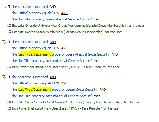

by (1.3k points)
I made no changes to the script.
conditions to update
I have highlighted adm-CustomAttributeText1
Thank you for the provided details. The thing is that the script searches for the exact text to replace and value references (e.g. %adm-CustomAttributeText1%) can only be used in the value part of the condition. We updated the script according to your requirements, find it below.

To run the script, you need to use the very same command, but the parameters should contain LDAP names of the property to replace (e.g. adm-CustomAttributeText1) and the property to set (e.g. department). Finally, the command should look like the following:
.\MyScript.ps1 -textToSearch "adm-CustomAttributeText1" -replaceWith "department"
by (1.3k points)
Thank you new script worked like a charm.
