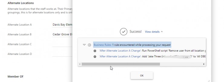

Unfortunately, it is only firing on the Alternate Location A changed and not even touching the others, Here is a screenshot of the result. Jake was added to two locations, but only the first rules actions applied.

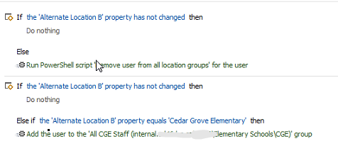

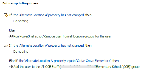

Here are a snippet of the rules... After Alternate Location A Changed... 2020-05-25 14_12_32Alternate Location A.png
After Alternate Location B Changed... 2020-05-25 14_11_43-Alternative Location B.png

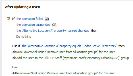

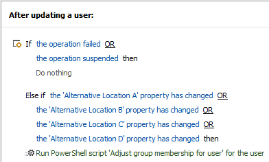

It is recommended to perform such actions after the update was made, not before it to make that the actions are performed on time. As such, your Business Rules should look like the following: image.png Additionally, you might consider using a single Business Rule and a PowerShell script that will adjust group membership for the user accordingly. In this case, the rule will look like the following: image.png If this approach meets your needs, please, provide us with all the possible details regarding the group membership update that should be performed when either of the alternative locations gets updated and we will provide you with the script.
You need to make sure that the Activity Scopes of all the Business Rules triggering upon alternative locations update include all the users for who they should trigger. image.png For information on how to check Business Rules effective for an object, have a look at the following help article: https://www.adaxes.com/help/?ManageBusinessRules.ViewBusinessRulesEffectiveForADObjects.html.
