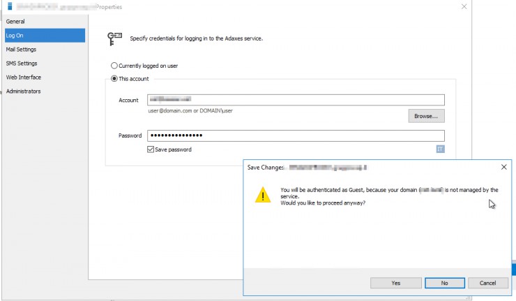

Perfect! Thank you so much for the information. I installed a new instance on a new server, I select New Configuration however when I specify the service credentials it gives me this error.. the Account is in the service administrators (it is the same as the first installation)
Hello Leonardo,
The warning means that the domain of account whose credentials you are trying to use to log on to the Adaxes service is not registered in Adaxes. For information on how to register AD domains, have a look at the following help article: https://www.adaxes.com/help/?HowDoI.ManageActiveDirectory.ManageDomains.RegisterManagedDomain.html.
