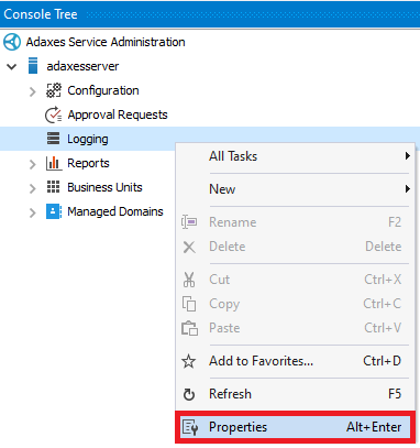

For details on how to view Adaxes logs, see https://www.adaxes.com/help/ViewOperationsPerformedViaAdaxes. As for changing the list of operations being logged, follow the below steps:
  2. In the Console Tree, right-click Logging.

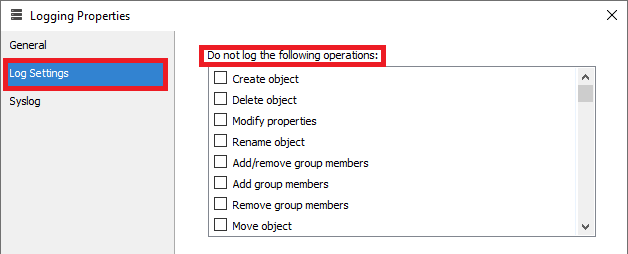

  4. Activate the Log Settings tab.
  5. In the Do not log the following operations section, clear the checkboxes for the operations that should be logged. image.png
  6. Click OK.
