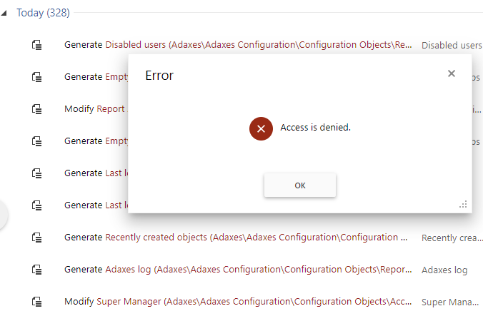

I've given a group of users permissions to the logging reports. They can review the logs but when clicking on an item they get Access Denied.
What permissions do I need to give the group to be able to read the logs?
by (810 points)
You need to grant users the permissions to view the General log. For details, have a look at the following help article: https://www.adaxes.com/help/?ManageSecurityRoles.AllowViewingGeneralLog.html.
